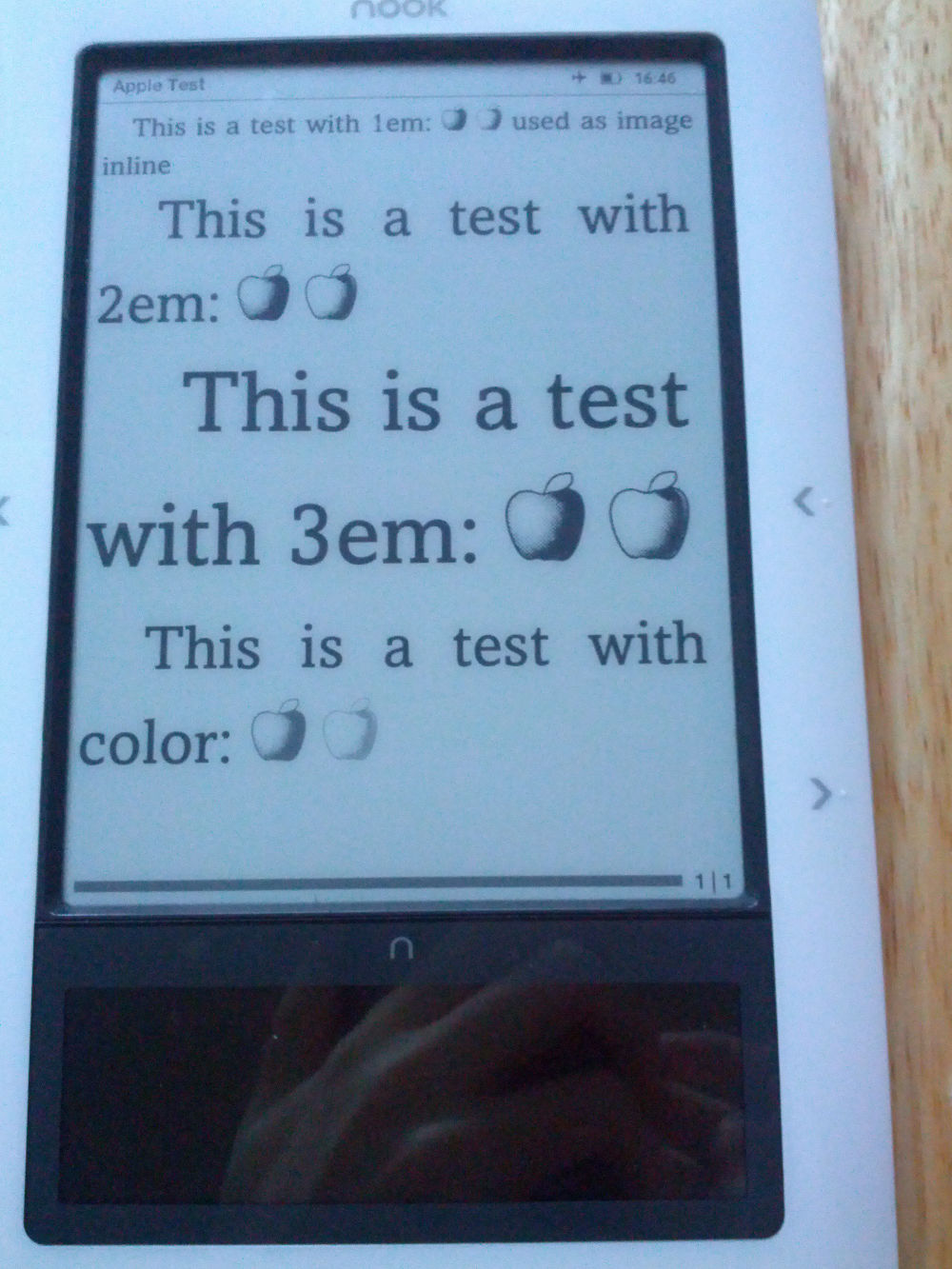

OK, here is my tutorial.
Fantastic, worked like a charm!
I went in and added the Green Apple (U+1F34F):
http://www.fileformat.info/info/unic...reen_apple.svg
I also tweaked the SVG file and changed "fill" into the hex for red and green.

On Nook:
Does this work on Marvin/other devices/reading programs too?
Anyone have any of the Kindles on hand? How well does this transfer over?
Kindle Unpack shows the SVG files sitting in the KF8 version. According to what I read in the Amazon Publishing Guidelines, I am getting mixed signals (SVG only in Kindle Fire (?)).
In section 8.4.2 they recommend using the SVG with an accompanying image. Setting the image to "display:none", and only displaying the image in old MOBI using media queries. UGH:
http://kindlegen.s3.amazonaws.com/Am...Guidelines.pdf
Not much information though on SVG in their documentation.
