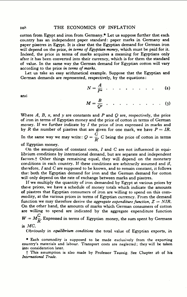

I am currently working on a book which has formula numbers down the right hand side of the page.

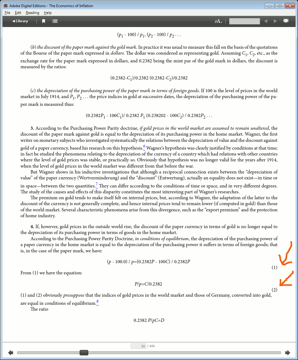

In ADE, it seems to drop the formula number down a line, instead of floating to the right edge of the same line. (Sigil looks as I expected).
I was wondering if anyone out there has run into this same problem, and what sort of code they used to fix the situation.
Currently, I am using this code:
<p class="center margintop">Formula Formula Formula <span class="floatright">(##)</span></p>

I have attached four things to this post:
  • image of the original book
  • the way my EPUB currently looks in ADE (marked with arrows)
  • the way it looks in Sigil (marked with arrows)
  • WIP EPUB
