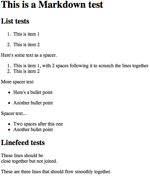

I'm getting a group of odd results with calibre's conversion of Markdown-formatted text files. Is this a bug worthy of filing, or do I just have something set wrong somewhere?
Here's a sample Markdown source file:
# This is a Markdown test
## List tests
1. This is item 1
2. This is item 2
Here's some text as a spacer.
1. This is item 1, with 2 spaces following it to scrunch the lines together
2. This is item 2
More spacer text
* Here's a bullet point
* Another bullet point
Spacer text...
* Two spaces after this one
## Linefeed tests
These lines should be
close together but not joined.
These are three lines that
should
flow smoothly together.
Here's BBEdit 10's preview, which looks fine:
After doing a Txt --> Mobi conversion in calibre, this is what the Mobi viewer shows:
And here's what it looks like on the Kindle 3:
I see these problems:
  1. List items in the converted book get shifted down from their bullets/numbers (on Kindle only)
  2. Line spacing isn't being correctly controlled when 2 spaces are added at the end of the first of two sequential lines
  3. Sequential lines of text aren't being joined together the way Markdown syntax says they should (calibre viewer & Kindle)
  4. (Also, calibre's mobi viewer seems to be adding extra vertical spacing at the top of a list; not quite the same topic though)
Should I officially report these? Or report myself, for lack of knowing what I'm doing?
The images are duplicated below: BBEdit / calibre's mobi viewer / kindle screenshots
