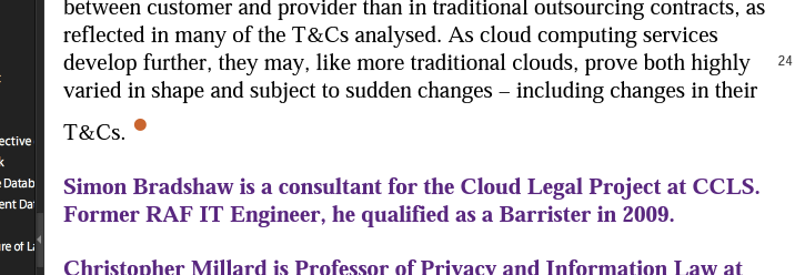

Hi all
We're attempting to match a print job in ePub. Obviously matching it exactly is not possible but I'm trying to carry as many design features as possible over to the ePub and one of them is at the end of the last paragraph there's a coloured bullet. No matter what I do I can't get the bullet to work in ePub - I can get it to appear, styled with a span, but I can't get it to sit on the line with the 'normal' text and not cause a gap in the paragraph (in ADE). See screenshots attached
The bullet in the attached ADE screenshot is styled as;
span.end-bullet {
color: #C9652F;
position: relative;
bottom: -0.2em;
font-size: 2em;
line-height: 0.9em;
which is a combination of lifting code from here and there. It looks better in Sigil - it's on the line but still causes a gap in the paragraph. There's got to be a better way that works in both...?
Name:	desired effect.png
ID:	72828   Click image for larger version
Name:	result in ADE.png
