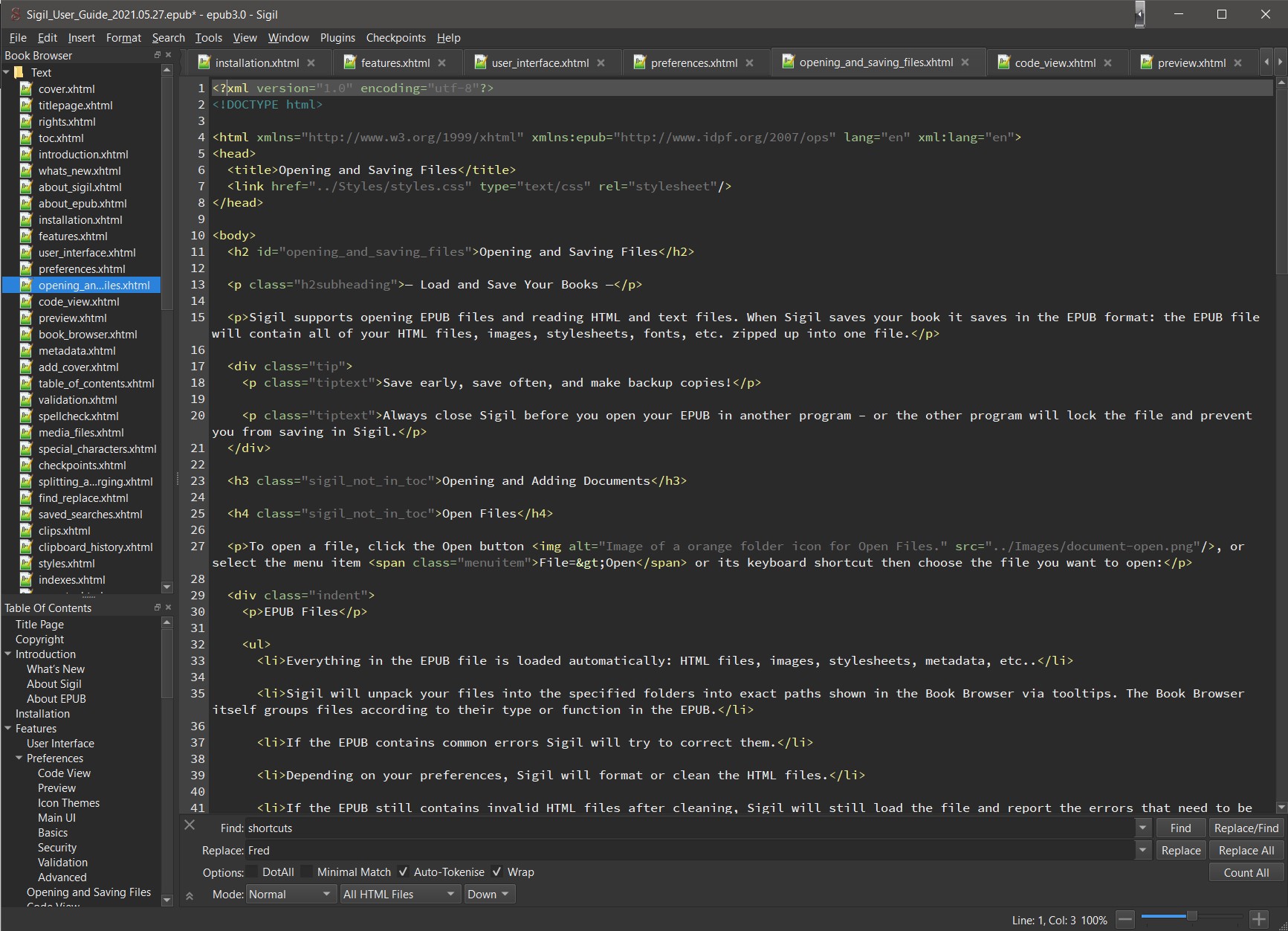

BetterRed 08-30-2021 07:22 PM
1 Attachment(s)
Originally Posted by hobnail (Post 4150356)
Brute force: I just clean up the excess tabs by pressing ctl-w (closes the selected tab) until only one tab is left, then open the file I want.
FWIW: there's a shortcut for Close other tabs, I have it as Ctrl+Alt+W, not sure if that's a factory or custom setting.
OT: I don't get shortened names in the CV tabs. I see this with every html file of user guide open :blink:
Attachment 189018
DiapDealer 08-30-2021 07:27 PM
Which version of Sigil are you using today? ;)

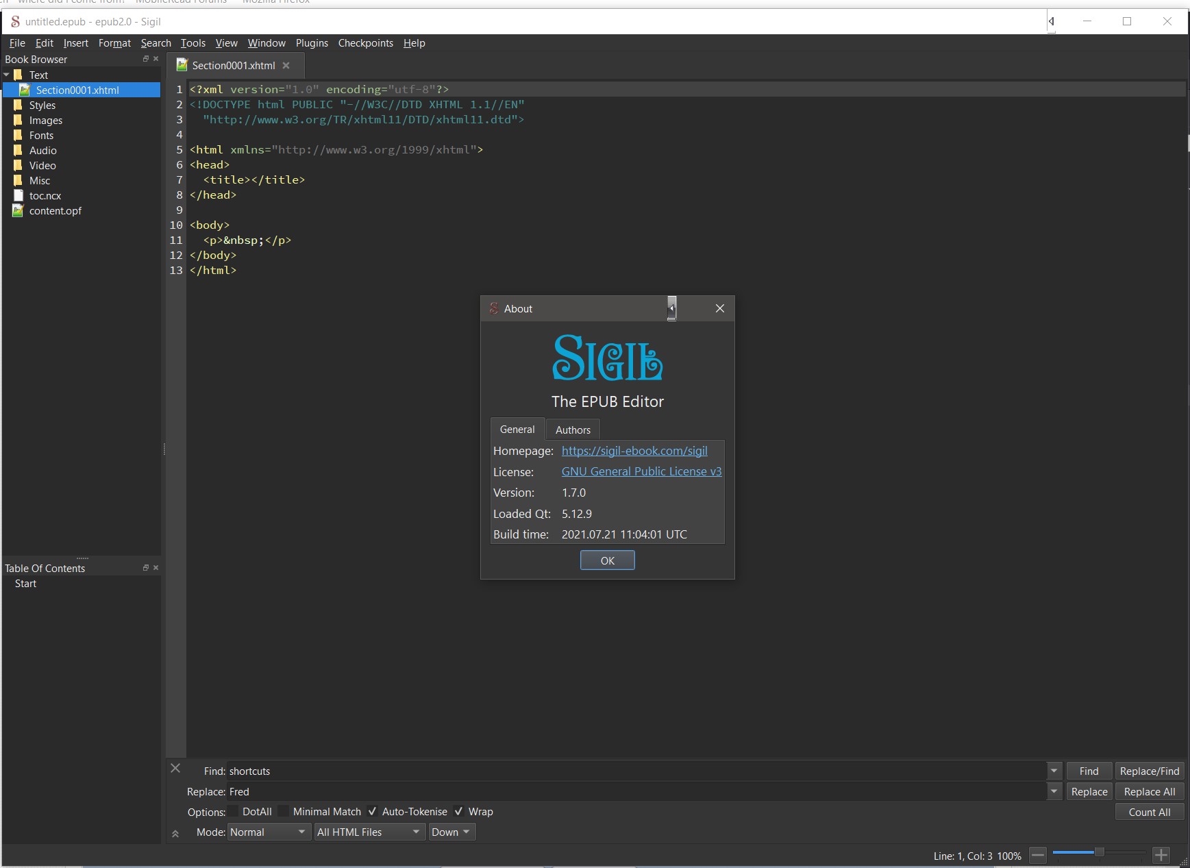

BetterRed 08-30-2021 07:40 PM
1 Attachment(s)
Attachment 189023
DiapDealer 08-31-2021 05:59 AM
Just checking. You had said something about going back to an earlier version recently. I just know the eliding of tab titles has gone through changes in the various Qt versions.
BetterRed 08-31-2021 06:58 AM
No worries - I installed 1.0 on another VM, so its there whenif I need it.
