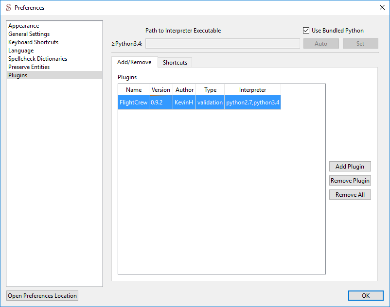

Step 2. In Sigil, press Edit > Preferences > Plugins.
Step 3. Press the Add Plugin button on the right side:
Attachment 185121
and select the ZIP file you just downloaded.
(In this case, wherever you put the "FlightCrew_v0.9.2win.zip" file. It may exist in your Downloads folder.)
After you add it successfully, FlightCrew should appear in your list:

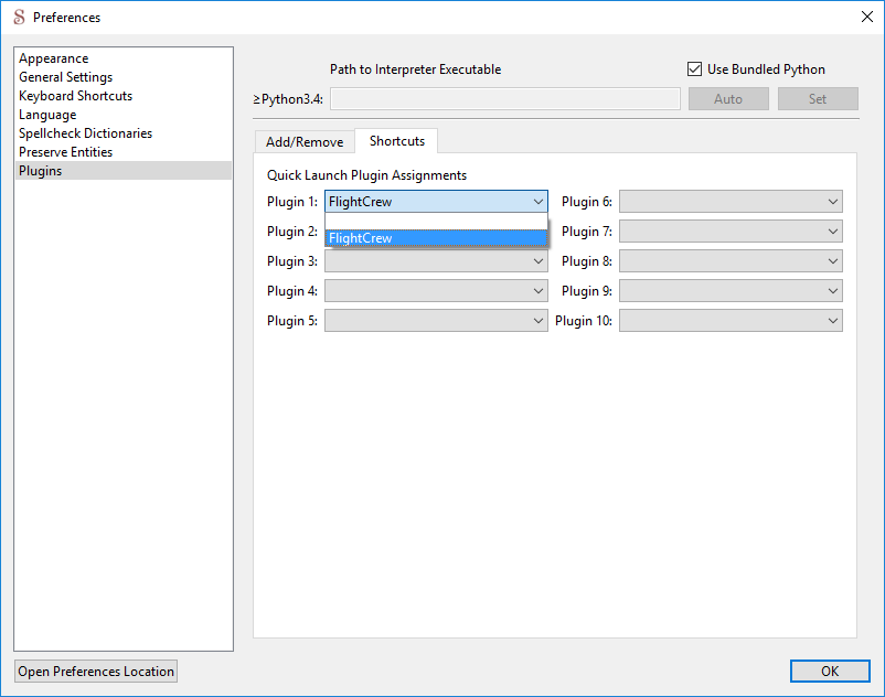

Step 4 (Optional). After FlightCrew is installed, you can assign FlightCrew to one of Sigil's "plugin buttons".
Press the "Shortcuts" tab.
Then click the dropdown for "Plugin 1:" and select FlightCrew:
Attachment 185123

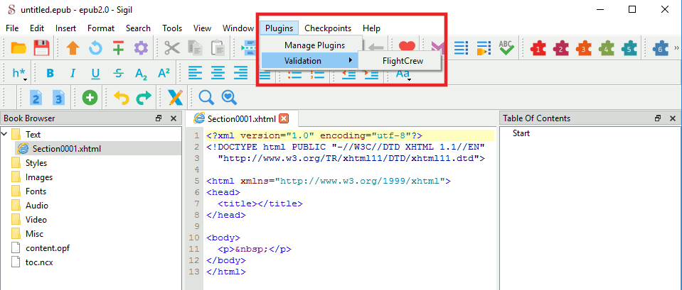

Step 5. FlightCrew can now be found under Plugins > Validation > FlightCrew:
Attachment 185124
Or, if you followed Step 4, you can press the "Plugin #" button you assigned:
Attachment 185125
(In this case, the "Plugin #1" button will act like the old "checkmark" button in older versions of Sigil.)
