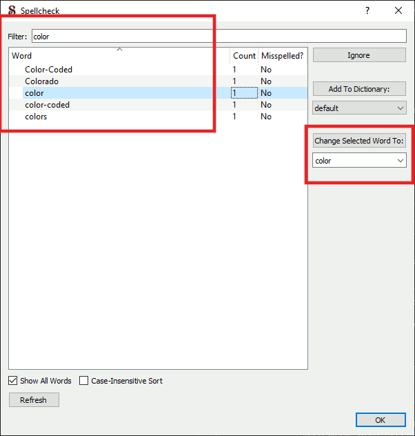

Tex2002ans 01-09-2021 08:17 AM
1 Attachment(s)
Originally Posted by Ashjuk (Post 4080013)
How do I make S&R case sensitive?
After you press Ctrl+F, you should be able to change Mode to "Case Sensitive".
How do I make S&R find and replace whole words only?
If you change Mode to "Regex", you can use Regular Expressions.
In Regular Expressions, \b = a word boundary... so if you wanted to search for a whole word:
Search: \bcolor\b
Replace: colour
Note: Regular Expressions are already case sensitive, so that won't match "Color" or "Colors". And since it's whole words, it won't match "colorimeter" or "technicolor".
Alternate Method
Your best bet will probably be Sigil's fantastic Tools > Spellcheck > Spellcheck.
This allows you to search through all words in a book in an easy-to-read list.
In there, you're also able to select a word, then "Change Selected Word to":
Attachment 184638
