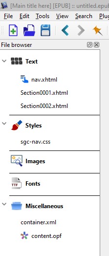

1 Attachment(s)
In Sigil the nav.xhtml is only movable in the Book Browser but that doesn't change where it's displayed when you look at the book in an e-reader; it's still at the end of the book. There is no secondary TOC. Here's what Calibre Editor's File Browser looks like after dragging the nav.xhtml to the top:
Attachment 175239

Doitsu 11-29-2019 06:07 PM
Originally Posted by hobnail (Post 3921716)
Having two TOCs isn't a big problem but I'm wondering why being able to use the nav.xhtml as the displayed TOC (by moving it in Calibre's editor) would be a problem.
You definitely can use the NAV document as a TOC. (For a proof of concept, see this simple MR EPUB3 book.)
Maybe your e-reader always displays the NAV document at the end of a book?
To test this open the EPUB3 book that I've linked to with Sigil, move the NAV document after the cover, save the book and open it with your e-reader.
If it displays the NAV document at the end of the book, it's the e-reader that causes this problem.
