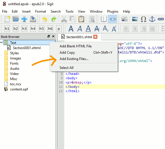

You could just create a folder with all the common template files you use.
Create a new EPUB, Right-Click in the Book Browser + "Add Existing Files":
Attachment 162367
I have a folder of common CSS + Front/Backmatter that gets used in every book that I just import in every time. Then I do whatever tweaks are needed.
