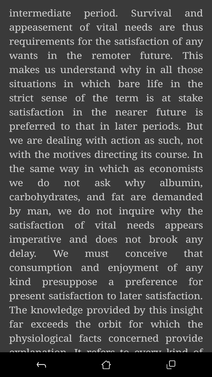

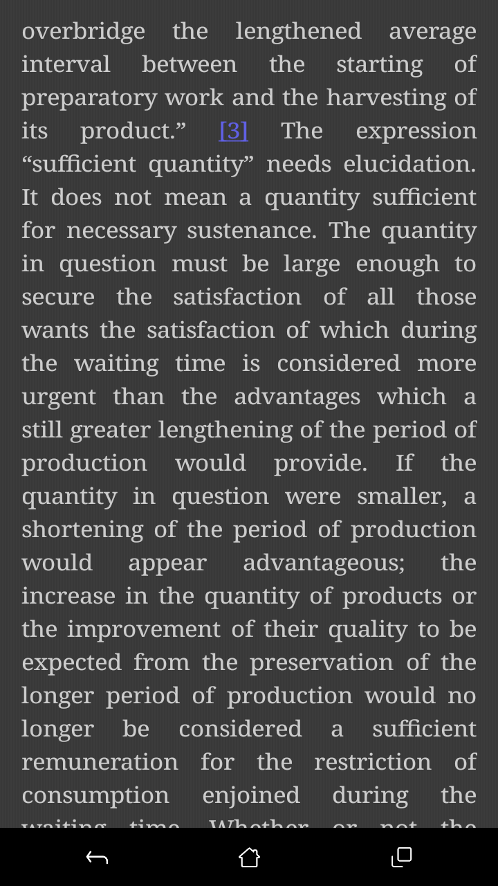

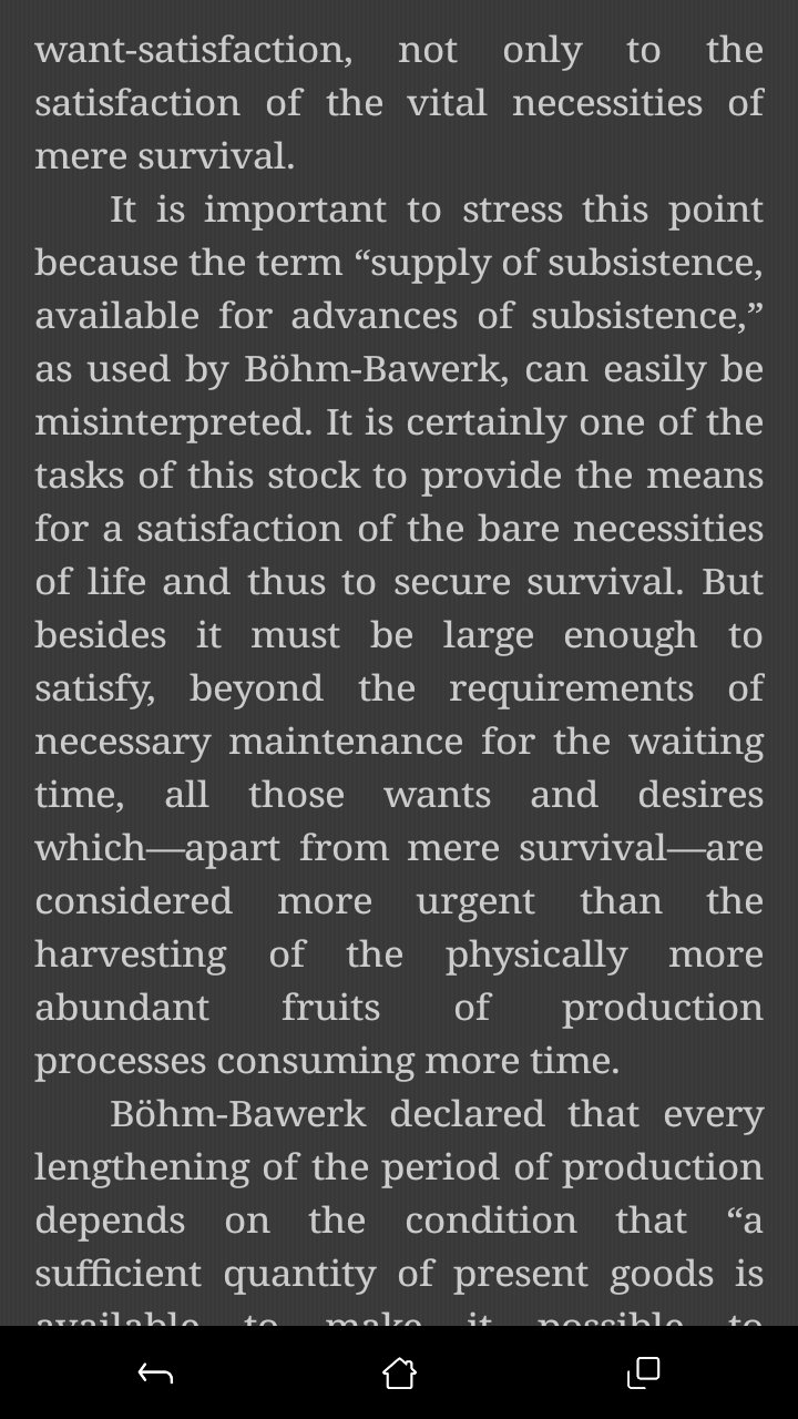

Ok, let me bust out my dusty ol' tome and hurt my hands dragging this thing to page 484! :D
PDF of Page:
Attachment 152204
Ebook (this is on my phone [much tinier than the physical page] with a slightly larger font size):
Attachment 152205 Attachment 152206 Attachment 152207
I followed the link to "Page 484", but I had to read through to the THIRD SCREEN before I found where he talked about "period of production".
As Hitch mentioned, depending on the variables, it could be ~1-5 Screens away from where I was dropped off!
Sure, SOME of the references might be exactly at the "top of the page", but the experience for a digital reader is very poor.
