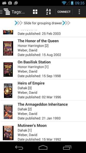

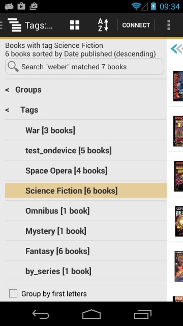

The following screenshots show CC with a search and sort active.
Attachment 143643 Attachment 143644
When I go from CC to the desktop using the "Home" button then tap the CC icon, I see the second screen again.
