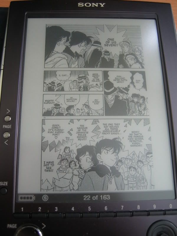

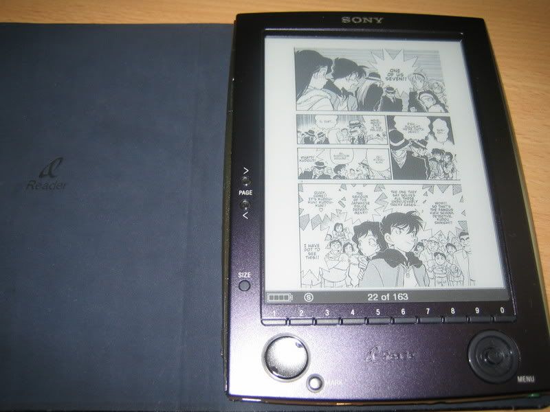

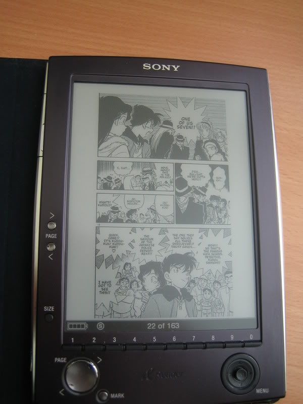

A few pictures I made of my new toy :)
http://img.photobucket.com/albums/v1...f/IMG_1023.jpg
http://img.photobucket.com/albums/v1...f/IMG_1021.jpg
