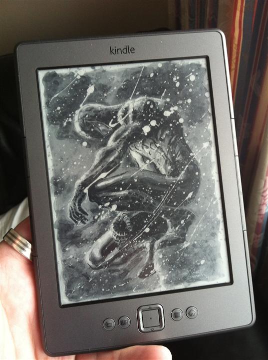

Screensaver hack does work
Hi, long time reader first time poster etc.
I notice in the wiki page it states that the quick Screensaver hack currently doesn't work... however it has worked for me.
First time I tried it I got the 'U007' error but it had successfully created the folders. So I populated these folders and I still had the default screensavers .
I went back into the folders and removed all of my new images and applied the update a second time. Same error message, put the new images back in the folder, same result.
I applied the update a third time, only this time I left my images in the screensavers folder before updating.... update successfull and the images have now replaced the originals and I have the custom screensavers now working.
I was a bit convoluted but maybe this is something to try (do the update with a U007 error, put in the custom images, then do the update again?)
But it does work....

Old 02-18-2012, 05:38 PM   #140
Slayer48
Slayer48 began at the beginning.
Slayer48's Avatar
Posts: 4
Device: Kindle 4 NT
Originally Posted by vtex View Post
You first have to disable the Special Offers. See here.
For all of you who think it is somehow unethical to do that, may I remind you that the Kindle runs GNU Linux. You are completely within your right to add files on the operating system (in this case a blank .assets file) as per the GPL.
ok total newb here so bear with me please. I tried to disable the ads following your instructions and when I get to the part where you create the text doc in the system folder, I create the file (g.txt) then go back and open the command window and when I type in (ren g.txt .assets) and hit enter it says it can't find the file. Am I doing it wrong, if so can you please explain it to me.
Also in this tutorial
(4. ssh into the device with putty
5. delete or rename the .assets folder located in /mnt/us/
6. delete or rename /var/local/adunits directory
7. delete or rename /mnt/base-mmc/amazon/screen_saver/adunits/600x800/banner.gif and screensvr.gif
8. delete or rename /mnt/base-mmc/amazon/screen_saver/600x800
9. create a link from /mnt/base-mmc/amazon/screen_saver/600x800 to your own screensavers (/mnt/us/screensaver): ln -s /mnt/us/screensaver /mnt/base-mmc/opt/amazon/screen_saver/600x800) Can someone please explain to me how to delete or rename these files,how to get to them and also how to create the link between the screensaver folders/files.
Any help would be appreciated.
Can you link to this quick screensaver method?

Old 02-22-2012, 05:41 PM   #145
Civpilot
Civpilot began at the beginning.
Device: Kindle 4
I got it off the wiki page...
http://wiki.mobileread.com/wiki/Kind...reensaver_Hack
The wiki states that it currently doesn't work but as my screen shot proves, it does work.
Civpilot is offline   Reply With Quote
Old 02-25-2012, 01:40 PM   #146
kartobot
kartobot began at the beginning.
Device: Kindle 4 NT
Well,for me,after trying like 5 times,the screensaver hack from the wiki page worked as well after rebooting. Eventually it said update successfull.
kartobot is offline   Reply With Quote

Old 03-12-2012, 05:55 AM   #148
Radi
Radi began at the beginning.
Device: Kindle 4 NT
Hello there, I just came to these forums to find out of I could get some screensavers on my K4NT as i was unable to with trying other sites..
I just registered here to say this method works and is a lot easier than changing settings through your networks etc..
I followed the Ixtab jailbreak method found here http://wiki.mobileread.com/wiki/Kind...reensaver_Hack
and then did the screensaver hack, I did get an error message but when I restarted the kindle and re-synced with the pc the linkss folder was there with the screenshots folder inside.
I put the screenshot I had in the folder, ejected and it didn't seem to work, so next reconnect to pc, put the screensaver hack back on the kindle but leave your custom screensavers in the screensaver folder. Update your kindle again and it should say update successful.
enjoy!
Radi is offline   Reply With Quote
