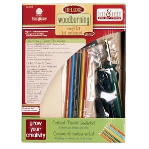

EDIT: I was given my first soldering iron (i.e. wood burning kit) when I was a young child. It did not take long to repurpose it.
Later, I used an inexpensive Radio Shack soldering pencil, which I connected it to an incandescent lamp dimmer to control the temperature:
Be sure to NOT use a soldering gun on a delicate PCB:
