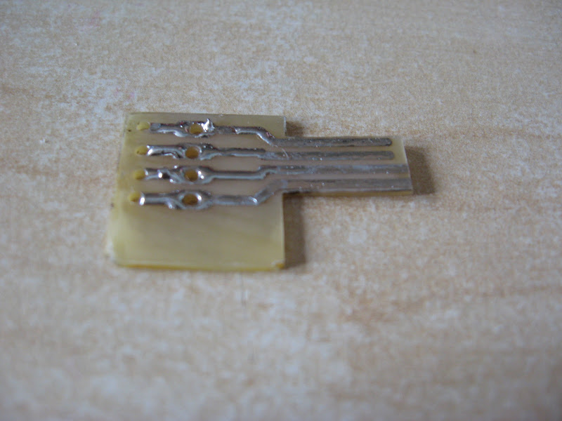

Interesting. The connector means that the serial port is for the first time accessible externally, with no hacking of the Kindle required.
The PCB has to be around 1mm thick or slightly thinner, which means you need to sand down a normal board before it fits. The track spacing is 1.5mm with 1mm width tracks.
Unfortunately, the serial port is 1.8v, which is lower than my DKU-5 Nokia cable goes. I do see good (continuity) connections using this method to the Kindle, though.
Above is a picture of the serial connector - it connects as follows:

Sucess. I have a u-boot prompt (not locked down) with a FET level converter.

What did you end up with on the width of the connector, from the pic, looks like 5.5mm. Also what baud rate is it using. I'm not new to Linux, just new to the arm versions.

6mm or so. 115200, N, 8, 1. Beware, it is a 1.8v port - If you apply 3.3v to it, you may well damage it.

Unfortunately, I can see no sign that uboot passes through the bootargs. Which means we can't just tag on init=/bin/sh.
You can also get to recovery mode (not just uboot) straight from the serial port by pressing a key at the right time.

I have just measured the current board I'm using properly - The PCB is 0.90mm.
I would seriously suggest that anyone considering a proper run of boards first makes a prototype to ensure that my measurements are OK.
